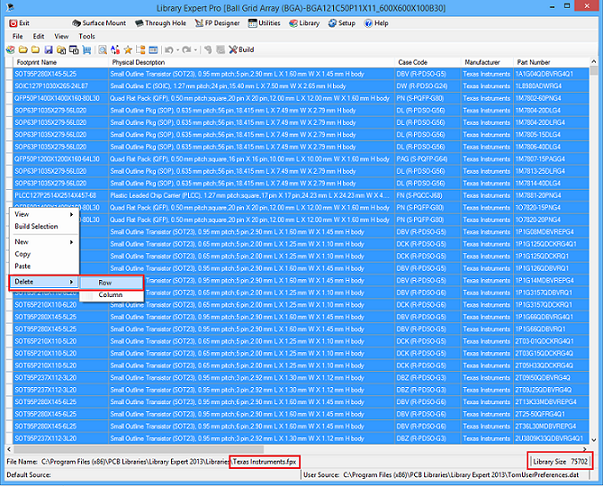

Post Options Post Options   Thanks (0) Thanks(0)   Quote Tom H Quote  Post ReplyReply Direct Link To This Post Posted: 22 Feb 2014 at 6:12pm
In the past 10 years since we've been creating IPC Footprint Calculators and Library Management documentation tools, I've never heard of anyone deleting thousands or even hundreds of Rows from an FPX file.
Normally, you would select the parts you want to keep and RMB select Copy and open a new Library and RMB Paste / File Save As / New Name . FPX
I opened the Texas Instruments FPX file with 75,702 parts and I selected all the Rows and RMB delete and it took 8 minutes. I tried the same thing with SM.fpx with 3,000 parts and it took 10 seconds.

Post Options Post Options   Thanks (1) Thanks(1)   Quote SteveD Quote  Post ReplyReply Direct Link To This Post Posted: 22 Feb 2014 at 10:53pm
Tom,
I am at home and cannot access the license from here to document the problem I saw further.  You are right.  It would not be a normal operation to perform.  As I recall I tried it after running into trouble with RMB based copy and paste.  I tried to cut from one set of rows and paste to another to change the display order in one trial (getting the items I wanted to move in a group), and another time I tried to RMB copy and paste to another file.  These did not work as I recall.  Later I found that it did work with edit cut or edit copy and edit paste to another file as you say.  So I then started experimenting and ran into the problem deleting a lot of rows.  Let me look at it further next week and report more accurately the specific circumstances.  Maybe I did not wait long enough for the delete to complete.  Maybe the times it seemed to hang, noted in another item, were when it was catching up with my delete request.  I do remember that when I selected a bunch of rows and clicked delete only one row seemed deleted, if any.  I need to test and see if RMB delete, Edit delete, and the delete key all work the same for highlighted items.

Post Options Post Options   Thanks (0) Thanks(0)   Quote SteveD Quote  Post ReplyReply Direct Link To This Post Posted: 24 Feb 2014 at 3:20pm
1. This does seem to work ok after all.  I must have been deceived by the long delay when deleting many many parts in a troubleshooting test.  This may also explain the 'hangs' I was experiencing.  If so, it would be helpful to tell people when something will take a while.
