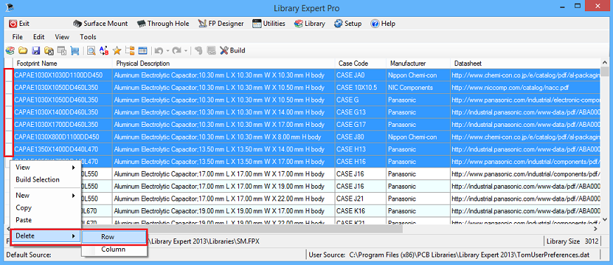

  1. Can't delete multiple rows with right click when many are selected.  Have to use edit  > delete

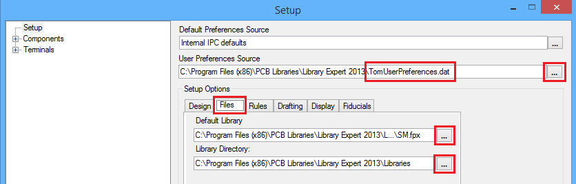

  7. I cannot edit the path to the Library Directory or the default library without browsing to it.

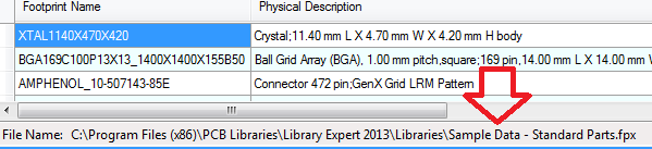

  9. It does not show me what library is open when I have the library view alone with no parts creation going on.  I need to see that before I save or doing any line item deletes.
In the Library Editor, if you select the Gray Rectangle Box to the left of the footprint name it will highlight the Row. If you click and drag or CTRL Click or Click scroll and Shift Click on the Gray Boxes you can select multiple Rows.
Then you can Right Mouse Button on any of the selected Gray Boxes and select "Delete > Row".
Open User Preferences and select the "Files" tab. Make sure that you create your own personal "MyUserPreferences.dat" and avoid making changes to "UserPreferences.dat" (which is the IPC default).
There you can use the ... box to browse to your Favorite FPX library file and your Default Library Directory on your computer or network -

10. It does not show me what library is open when I have the library view alone with no parts creation going on.  I need to see that before I save or doing any line item deletes.
It appears at the bottom (in the Status Bar) of the library window in either full or partial screen mode.
