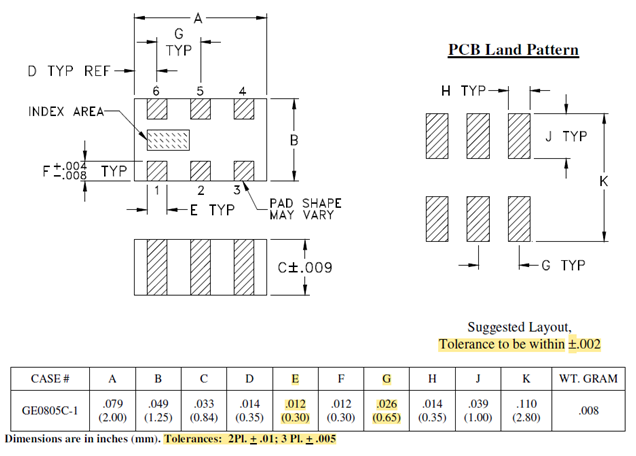

Quote MINI-CIRCUITS has a wide range of RF devices with non-JEDEC/custom package types, e.g. the selected DLFCG-540+ (Case GE0805C-1) 6-pin SMT ceramic filter.
In this case (and for their other components), the part outline has tolerances both on the termination width E (which is normal) and the pitch G (which, I think, is singular). The same G pitch value is used for their PCB land pattern recommendation, with different tolerances. Note - "Suggested Layout Tolerance to be within +/-.002"
Looks weird to me, at least unusual. As far as I know, the component termination pitch has no related tolerances and has often a BSC (Basic Spacing between Centers) mention.
We faced placement issues with this part and are about to discuss the point with MINI-CIRCUITS.
Below is an IPC-7352 extract that does not help and confuses me. I would have rather see the sentence as "the pin pitch of the land pattern should match the pin pitch of the component datasheet" (or POD, drawing).

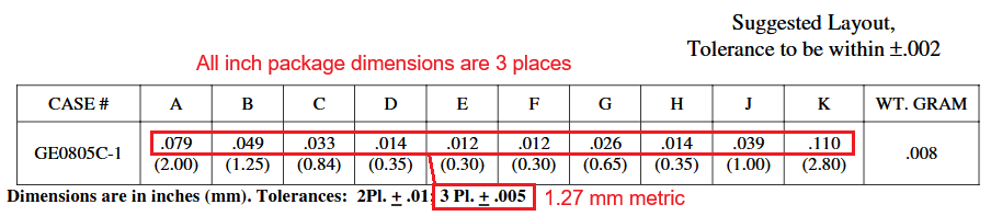

Manufacturer package tolerances are mostly too robust and not reality. They don't realize that their tolerances impact pad stack calculations and all the drafting outlines that are mapped to the maximum material condition.
Any package with dimensions like a 0805 package should have a realistic maximum tolerance of 0.15 mm max, 0.10 mm nom. or 0.05 mm minimum. We prefer to use the minimum tolerance of 0.05 because it's realistic.

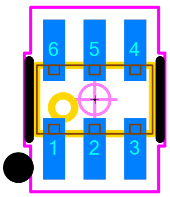

Here is the Mini-Circuits Recommended Pattern using their negative tolerance.
Pad stacks are too way robust for their minimum material condition.

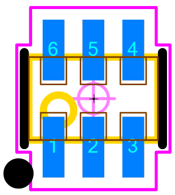

Here is the Mini-Circuits Recommended Pattern using their positive tolerance.
Not sufficient pad stack for maximum material condition.

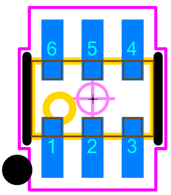

Here is the Mini-Circuits Recommended Pattern using no tolerances.
Perfect pattern for a package using no tolerances.
