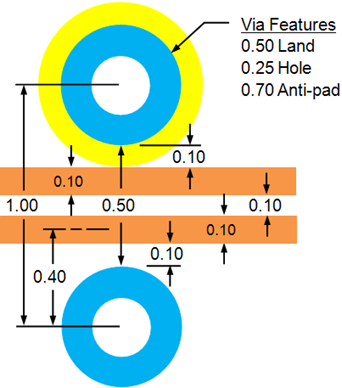

                                                               i.      Best Signal Trace Width = 0.10 mm – this allows differential pairs for a 1.00 mm pitch BGA
                                                             ii.      Power Trace Widths = 0.20, 0.30, 0.40, 0.50, etc.
                                                           iii.      Routing Grid = 0.05 mm
                                                           iv.      Via Pad Size = 0.50 & Via Hole Size = 0.25
                                                             v.      SMD Via Fanout should snap to a 0.10 mm grid if possible
