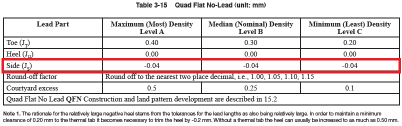

The Side solder joint goal for the "Flat No-Lead (Side)" is set to -0.04.
If this is troubling you and your engineers then do this.
Go to "Tools > Options > Terminals > Surface Mount > Flat No-Lead (Side) > Side goal" and change the value from -0.04 to -0.02 and your pad width will recalculate to 0.36 mm
All the values in Footprint Expert are editable. If you don't like a value set forth in the IPC-7351B standard then change it.
Here is the Flat No-Lead Table 3-15 in IPC-7351B (and an explanation of the negative solder joint goals:

You mentioned that the default side solder joint goal for a Flat No-Lead QFN is 0.03 mm smaller than the maximum terminal lead width.
Tell your engineers that you're adjusting the "Guideline" by less than 1 mil because you're paranoid that the pad width is too small.
The main reason why the Guideline suggests a -0.04 mm side goal is because of the 0.40 mm pin pitch QFN where the pad sides would be too close together and violate your minimum pad to pad spacing.
Also, you can't run a trace between a 0.50 mm pin pitch QFN. So the maximum lead hanging over the pad slightly won't affect anything.
