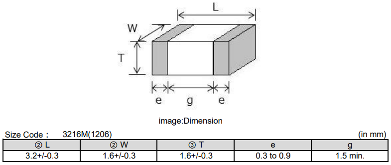

Here is an example of a 1206 capacitor from Murata.
Part Number: GRM31CC72A475KE11L
Case Code: GRM31C
Here are the package dimensions. every value has a 0.30 mm tolerance.

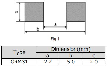

Here is the manufacturer recommended footprint:

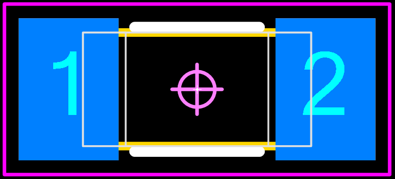

Here is the footprint using Nominal Package dimensions and the mfr. pattern. Notice the terminals are off the pad stack. No Heel.

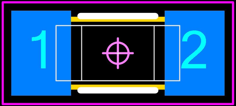

Here is the minimum package material condition according to the tolerances and the mfr. recommended pattern. The terminals are way off the pad stack. No Heel.

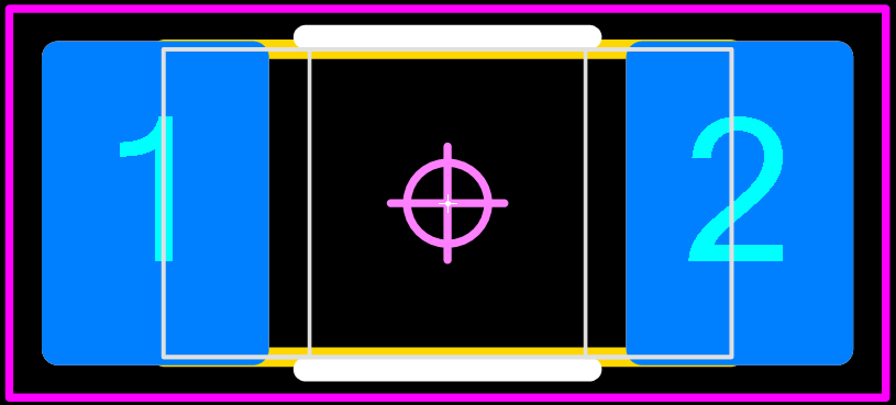

Here is the maximum package material condition according to the tolerances and the mfr. recommended pattern. No Heel and minimum Side fillet.
The mfr. recommended pattern does is not compatible when the component package comes in minimum, nominal or maximum material condition.
Try this out with your chip manufacturer recommended patterns to ensure that the pad stacks will accommodate a package in all material conditions. If not, the package and terminal tolerances could be too robust.

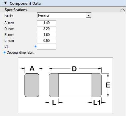

We're not against using the manufacturer recommended patterns, but if you do use them we highly recommended using the Footprint Expert 'Nominal Calculation Mode'.
Using the mfr. recommended pattern completely ignores the component package and terminal tolerances in the IPC-7352 mathematical model. Mfr. patterns ignore all tolerances, so there's no use in spending time inserting them into a footprint Calculator.

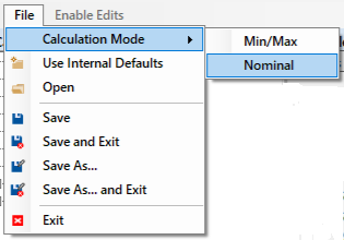

To turn on the Nominal Calculation Mode in Footprint Expert, select 'Tools > Options > File > Calculation Mode > Nominal'.
This feature turns off all tolerances in the component family Calculators to greatly simplify the data entry.
The Nominal Calculator has preset solder joint goals that have a fixed Toe, Heel and Side value. All solder joint goal values are editable for you to customize to meet your assembly shop guidelines for maximum quality in assembly attachment.
