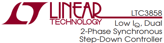

Linear Technology:
IC, Low IQ, Dual 2 Phase Synchronous Step-Down Controller

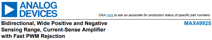

Analog Devices:
IC, Bidirectional, Wide Positive and Negative Sensing Range
