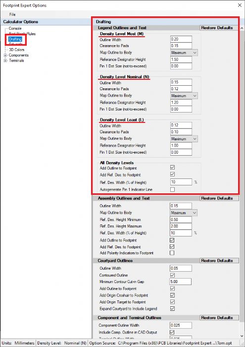

When I change Legend Clearance parameter in the settings, it applies only for N density footprints. M and L density remain the same as they were before change.
Is there a way to setup rules for Legend outline in a PCB Libraries for all densities?
I want to export whole .fpx file to Altium and it would be great if I can do it automatically without any manual steps in between.
Thanks.
Post Options Post Options   Thanks (0) Thanks(0)   Quote Tom H Quote  Post ReplyReply Direct Link To This Post Posted: 16 Oct 2020 at 7:19am
Silkscreen is a 3-Tier feature.
In V2020 you must select each Density Level separately and change the settings for each one.
We changed that in V2021. You will be able to see every density level at the same time.
