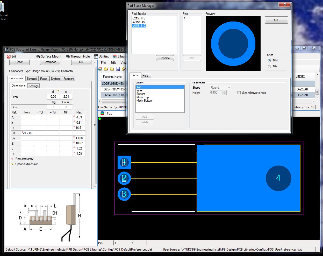

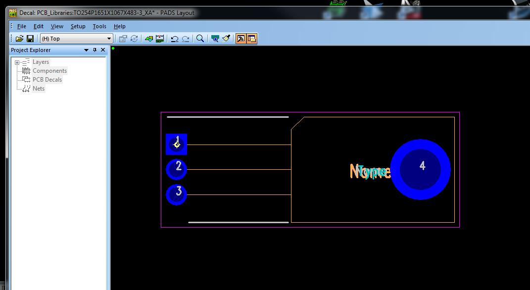

I am currently trying to build a TO-220 leaded transistor in PCB Libraries. All goes fine with the creation within the tool graphically, but when I import it into my PADS library (ver 9.3.1 if relevant) the 4 th pin does not have the large thermal pad associated to the hole (see image).
I also noticed that graphically the large pad shows as expected (see image).
However if I open the padstack viewer only the underlying hole is displayed there as well.
And as for the version I am on 2012.47
In any case I will add them directly to this post anyway.
