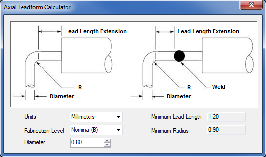

How to calculate pitch for axial lead components? IF mounted horizontally and vertically?
Points: 6104
Post Options Post Options   Thanks (0) Thanks(0)   Quote Tom H Quote  Post ReplyReply Direct Link To This Post Posted: 18 Mar 2013 at 6:27am
The PCB Footprint Expert has a "Utilities" button in the Main Toolbar. Select the "Axial Leadform Calculator" option and this menu will appear -
I hope this helps...
