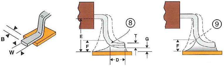

However, IPC-J-STD-001 does have several comments on the Gull Wing Terminal Heel solder joint. The F dimension.
  • The F dimension for Heel Fillet for Class 1 Fabrication is: Wetting is evident
  • The F dimension for Heel Fillet for Class 2 Fabrication is: (G) + 50% (T)
  • The F dimension for Heel Fillet for Class 3 Fabrication is: (G) + (T)

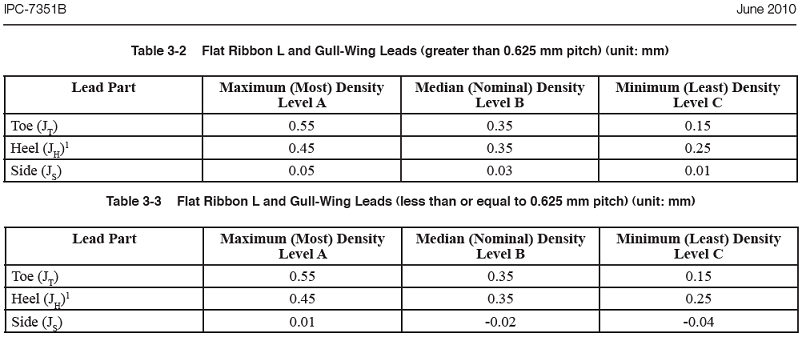

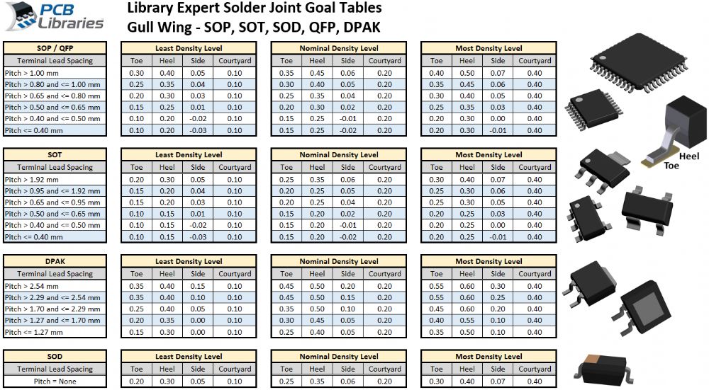

Here are the IPC-7351B Solder Joint Goal tables 3-2 & 3-3 for the Gull Wing Terminal Lead. Notice that the Toe and Heel solder joint goals are the same value for every Gull Wing lead. Also notice that the difference between Most, Nominal and Least Density Levels are in 0.20 mm increments. PCB Libraries, Inc. believes that this margin between density levels is too steep. The Most density level is too large and has too much solder and the least density level is too small and does not have enough solder.
Gull Wing affects the component families SOP, QFP, SOT, SOD and DPAK.
This is where PCB Libraries and IPC go our own separate way. IPC-7351B Nominal Density Level recommends a 0.35 mm Toe and Heel regardless of the component family, lead pitch and Terminal Lead Frame Thickness. The Lead-Frame Thickness on a common DPAK is 0.65 mm but the Lead Thickness on a 0.50 mm pitch QFP or SOP is 0.15 mm. They do not require the same Toe value

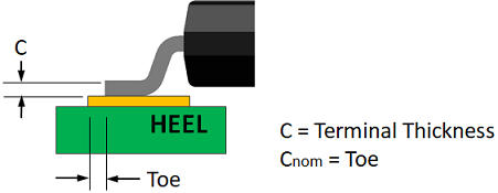

PCB Libraries, Inc. believes that the Toe value should equal the Lead-Frame Thickness to show visible wetting in the Toe solder joint. Here is a simple image of this philosophy.

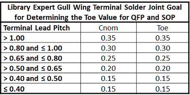

PCB Libraries created an Incremental pad stack concept for Gull Wing Leads based on Terminal Lead Thickness, which is primarily based on the Terminal Pin Pitch.
PCB Libraries, Inc. believes that this margin between density levels should be more subtle and swing 0.10 mm from the Nominal density level to the Most and Least density level. If you compare IPC-7351 with the original IPC-SM-782 land pattern standard that existed for 18 years, the SM-782 standard was about 0.10 mm larger than the 7351 Nominal.
PCB Libraries, Inc. in conjunction with our top tier customers, created an Incremental pad stack table based on the Terminal Lead Frame Thickness which is derived from the pin pitch.
Download the Library Expert Excel spreadsheet Solder Joint Goal tables here – www.pcblibraries.com/downloads
Also, if you are a Library Expert user, the Solder Joint Goal table Excel spreadsheet is already on your computer in this folder:
C:\Program Files (x86)\PCB Libraries\Library Expert 2019\Documents\Library Expert Solder Joint Goal Tables.xlsx

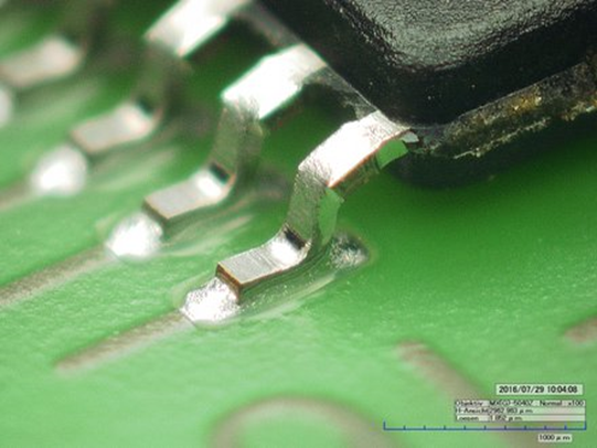

Here is an image of a real Gull Wing package with an adequate Toe Solder Joint. Not too big and not too small.

I see the recommended Toe, Heel & Side solder joint goals from your tables (IPC-7351C Proposed Solder Joint Goal Tables for Least Density, but can you tell on what size do you apply these values from component datasheet?
I apply these values to E dimension mean values from 2.40 mm and 1.80 mm or to max value 2.40 mm and also what L value do i use 0.46 or the mean of 0.46 and 0.26?
Br.
Post Options Post Options   Thanks (0) Thanks(0)   Quote Tom H Quote  Post ReplyReply Direct Link To This Post Posted: 27 Jul 2020 at 8:32am
No, this assumption is entirely incorrect.
The Solder Joint Goals are in addition to the Manufacturing Tolerances and the Component Package and Terminal Lead Min./Max. Tolerances.
We use the IPC-7351 mathematical model that is illustrated in IPC-7351B.
See the Surface Mount References Calculator for the math formula.
It's in this folder on your computer: C:\Program Files (x86)\PCB Libraries\Library Expert 2019\Documents
File Name: PCB_Library_Expert_SMD_Reference_Calculator

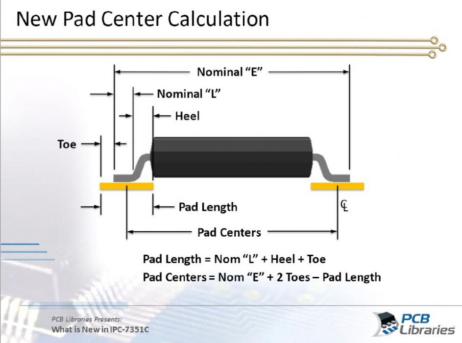

But how i can apply this calculator to SC70 package from the link?
Because i'm also looking at document what is new in ipc-7351c page 38 an fog gull wing pad length is nominal L + toe + heel ?
so for SC70 and nominal density = 0.35mm + 0.15mm + 0.2mm ?
Br.
Post Options Post Options   Thanks (0) Thanks(0)   Quote Tom H Quote  Post ReplyReply Direct Link To This Post Posted: 27 Jul 2020 at 9:12am
Use the SOT-23 Calculator for all Gull Wing leaded parts that have 3, 4, 5, 6 and 8 pins with various pin pitches.
IPC-7351C is not released and it's not going to contain all the new features that we wanted.
Whatever version of IPC-7351C you have is not correct (unless you're on the 1-13 Land Pattern Committee and got a Working Draft from IPC).
You cannot manually do the math to calculate an accurate pad stack and its location. You need a calculator.
