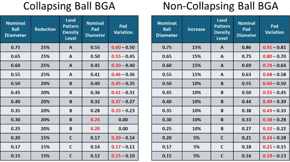

IPC has a rule for BGA pad size tolerances. They take a Nominal Ball and reduce or increase the pad size by a percentage, then add a pad size tolerance (variation). IPC-7351 recommends using the Maximum Material Condition of the Variation.

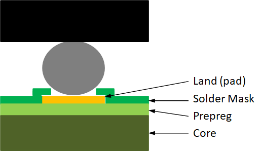

All BGA balls collapse. Non-collapsing BGA balls are created by the PCB librarian by solder mask defined pads or making the pad size larger than the Ball.
Collapsing Ball.
Non-Collapsing Ball defined by Solder Mask.
IPC-7351 BGA tables for pad size reduction for collapsing balls and pad size increase for non-collapsing balls. The pad size increase is normally used for fine pitch BGA's that require via-in-pad technology for fanout.
There are 3 Density Levels A, B and C that indicate the percentage amount for pad size calculation.

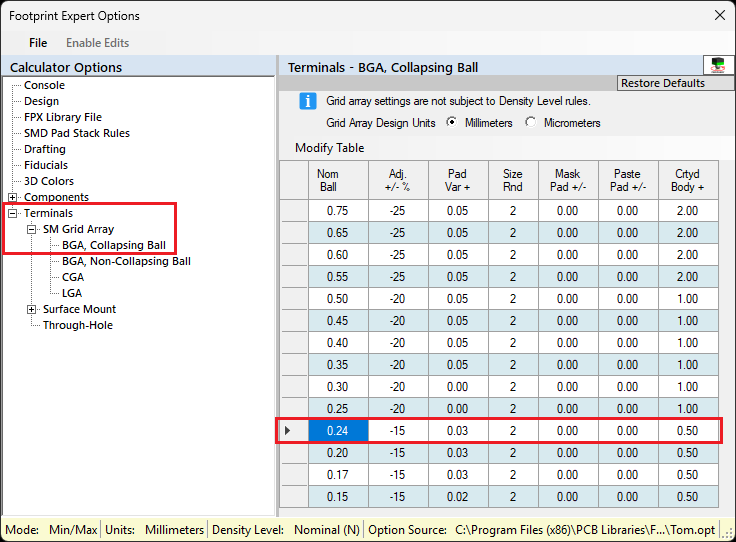

For the collapsing BGA ball with a diameter between the values listed what is appropriate reduction?
My example is a 0.242 mm diameter. Is the recommended reduction 15%, 20%, or 19.2% (linear interpolation)?
Points: 5909
Post Options Post Options   Thanks (0) Thanks(0)   Quote Tom H Quote  Post ReplyReply Direct Link To This Post Posted: 28 Mar 2025 at 1:38pm
If the Ball diameter is on the dividing row between percentages the new ball size will take the lower values.
Here is a sample BGA terminal option table where the 0.24 mm Ball Diameter was added.
