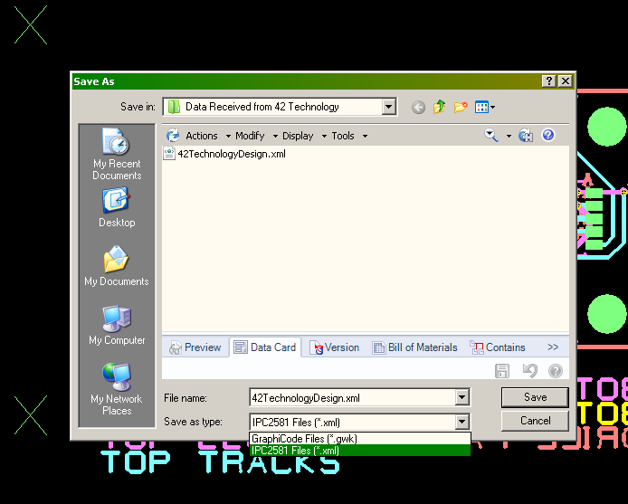

GC Prevue has a SAVE AS IPC-2581 option, as below, but I haven't had any success using it.

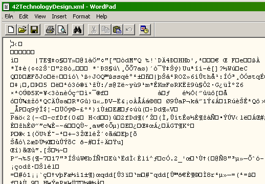

The resultant XML file cannot be read by WiseView nor Vu2581, my two viewers.  It appears to be a binary format file rather then the ascii that I've been advised should be present.
I've been told that the format of a correct file should be:
<?xml version = "1.0" encoding = "UTF-8"?>

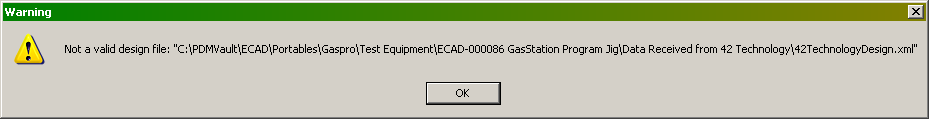

GCPrevue will open it okay, not unsurprisingly, but WiseView displays the error:
I appreciate this is a very new standard that's still being developed.  The only sample files I have at the .cvg format ones, not .xml so wasn't entirely sure if there'd be a difference in the two different formats.
