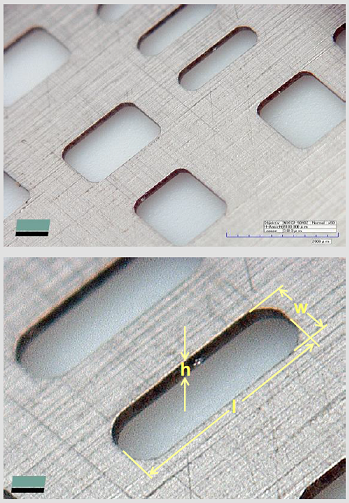

Using the IPC standards used by Footprint Expert, is there an intended stencil thickness being considered?
Stencil thickness is relevant since it is a factor in the volume of paste deposited, and the aperture area ratio/aspect ratio affecting paste release.
For example, I often see example stencil designs on Texas Instruments datasheets that are given for a 0.125mm stencil thickness.

0.125 mm is a standard paste mask stencil thickness.
But microminiature footprints might have the stencil thinned to 0.10 mm.
IPC-7525C Stencil Design Guidelines is the leading document.
Rounded Rectangle apertures help stencil release for lead-free solder alloys.
