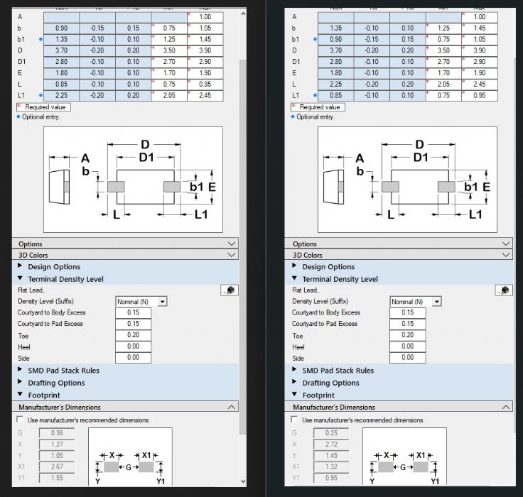

I have noticed that depending on the order in which you provide the dimensions for the SODFL package, the layout recommendation differs.
If you switch the b1 dimension with b and L1 with L, you get different padstacks. Is it a bug in the software or is there some other reason for such results?
I use the latest version of the PCB Footprint Expert.
Please see the attached screenshot for the comparison:
