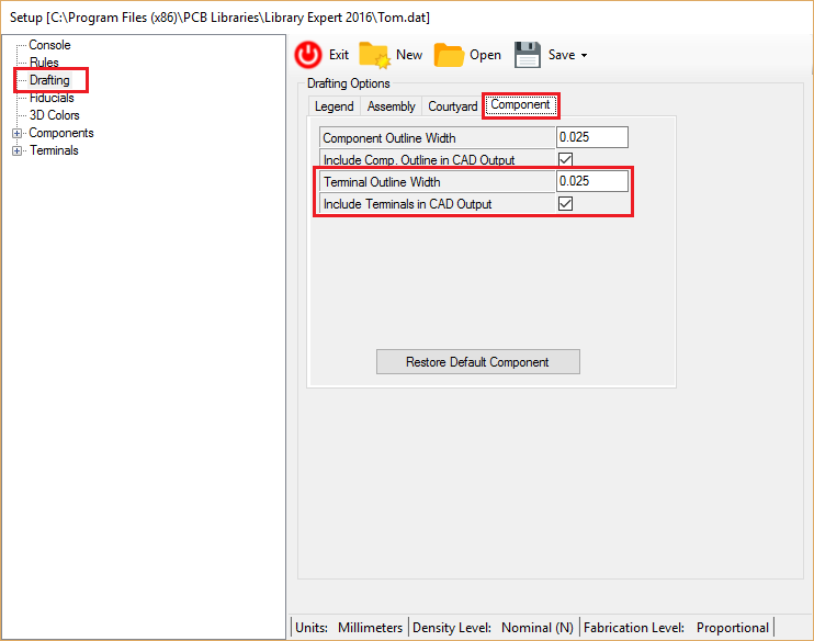

The Library Expert user determines all the CAD tool output parameters.
To control the "Terminals" select "Preferences > Drafting > Component"

I did find that option and I deselected it.  But again, not sure why it is there and why advantage it provides.  The mechanical engineer requested the IDF due to file size and other reasons.  I sent the engineer a STEP file and he wants IDF, but the two new components I created are coming in too large as if it's using the pick box.  PADS output report says it found the shape on L25, but it's not correct.
