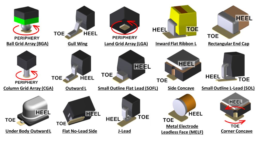

However, if the case ever occurred where you need to calculate a pattern, you need to know the terminal lead style.
You can open a component family calculator that uses one of the terminal lead styles and enter package and terminal dimensions. Then move the footprint to FP Designer to customized the pad stack pattern.
