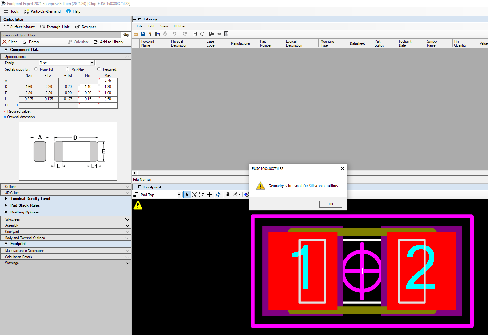

I'm new to the tools and PCB footprint design in general and I haven't had any luck searching for this in the forum so far. I'm creating a simple 0603 footprint for a PPTC fuse and I'm getting the attached warning after calculating:
I have "Use manufacturer's recommended dimensions" UNCHECKED, so this calculation should be the IPC-compliant version of the footprint. I would think it would be possible to fit the silkscreen annotations in a 0603 footprint, no?

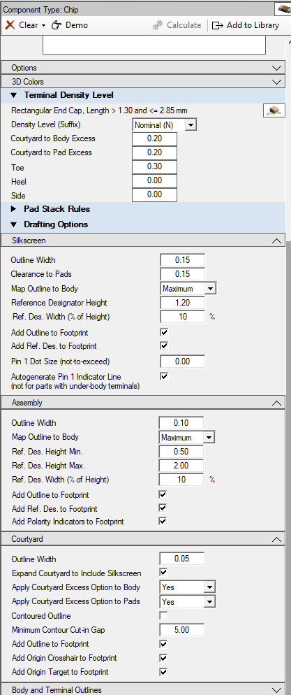

My relevant drafting settings are as follows:

Post Options Post Options   Thanks (1) Thanks(1)   Quote Tom H Quote  Post ReplyReply Direct Link To This Post Posted: 15 Nov 2021 at 10:27pm
The silkscreen outline is auto-generated by your Option Settings.
If Footprint Expert only obeys your rules. To small is to small to obey your rules.
You have 2 options.
  1. Add a Drafting Outline > Rectangular > Silkscreen > your x/y dimensions - then save to FPX library
  2. Move the chip from the Calculator to FP Designer. FP Designer auto generates a silkscreen outline if the rules are violated.
