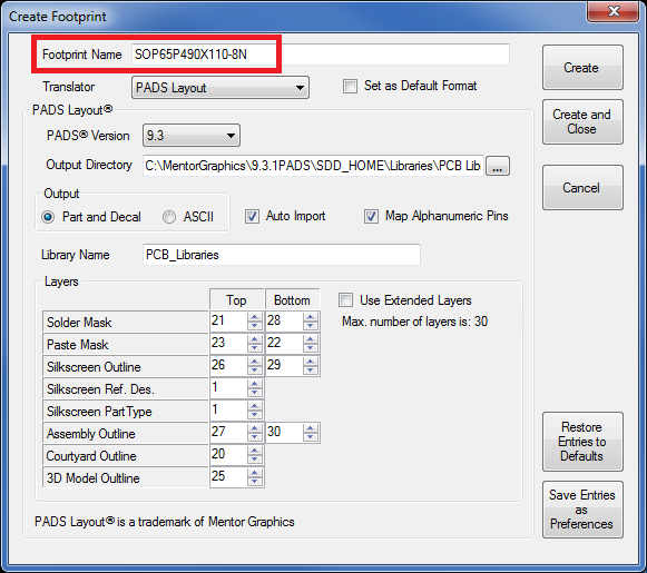

You can edit the Footprint Name in the CAD Translator menu.

You edit the Footprint Name in the CAD translator menu -
