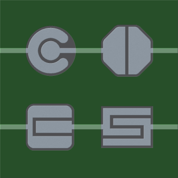

Does anyone have experience generating good (or bad!) footprints for solderable jumpers?  I'm looking to configure a circuit board with something like this:
Or this:
I want something that is easy and quick to connect, but also easy to desolder and clean up for reconfiguration.  If it makes any difference, the intent is to use lead-free solder.
Has anyone done this, with good or bad results?  Can anyone provide pointers?  Better yet, dimensions / configuration or even an Altium footprint for a "known-good" solder jumper?

Your picture is an OK example.
There are just a couple rules -
  • The Gap should be the same as your trace/space
  • No solder Mask in the Gap
  • The pad size should be able to carry whatever current you're using
Here are some alternate solder jumpers that work well -

The options with the interdigitated contacts look like they would be very easy to short reliably, but I'm worried about the difficult of cleaning them up if the configuration needed to change.  I'm sure solder wick and flux could clean them out, but I really want something easy to work with.
Have you personally soldered and desoldered all of these?  If you were tasked with reconfiguring a thousand of these jumpers, which would you prefer had been used on the board?

I'm an IPC CIT trainer for soldering and J-STD-001 solder joint acceptability and these patterns clean up really nice.
Place a solder wick on the solder and apply the iron and the solder wick sucks up the solder and with a wire mesh touchup it should be clean to go.
Old fashion pad with hole and wire is still a popular Jumper solution. Even a wire loop across 2 SMD pads with easy access to cut. No need to use a solder iron.
