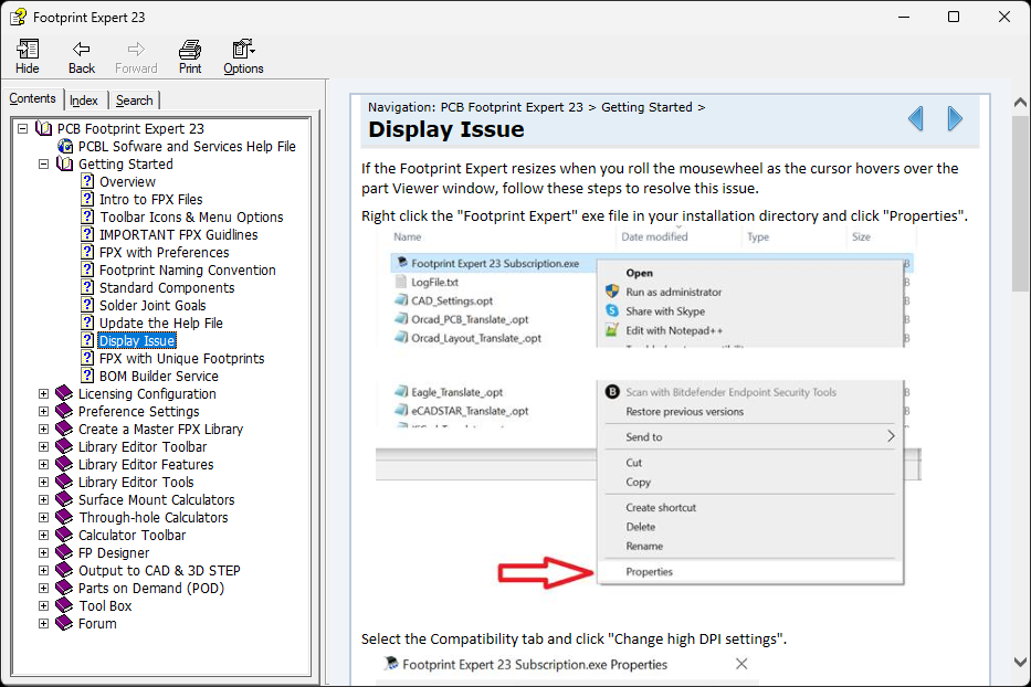

Post Options Post Options   Thanks (0) Thanks(0)   Quote Tom H Quote  Post ReplyReply Direct Link To This Post Posted: 18 Apr 2024 at 12:11pm
Read the "Help > User Guide > Getting Started > Display Issue".

Hi Al,
It sounds like you're experiencing a common issue with high-resolution displays where text and interface elements appear too small. Changing the monitor's resolution isn't always the best solution, as it can result in blurry text, as you've noticed.
Instead, try adjusting the scaling settings in your operating system. For Windows, go to 'Display Settings' and look for 'Scale and Layout'. Here, you can increase the size of text, apps, and other items without changing the resolution. If you're using a Mac, go to 'System Preferences', select 'Displays', then 'Scaled', and choose a larger text option.
If the PCB Footprint Expert program has its own display settings, check there for font size adjustments. Some programs allow you to customize the text size independently of the system settings.
Remember, each program may have different ways to adjust the display, so consult the software's help resources if needed.
