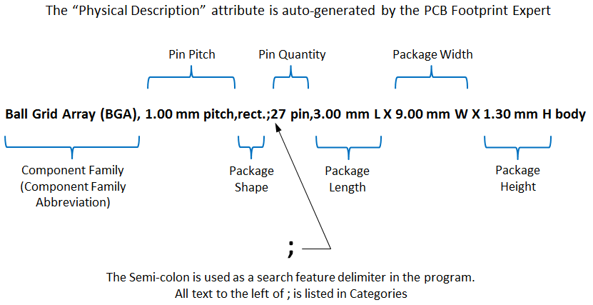

The Pin Qty is the last number in every Footprint Name (except BGA's).
Use the "Category" feature, to narrow down the Component family and Pin Pitch.
However, you are in 100% control of the "Category" feature. You can add the "Pin Qty" to the left of the semicolon.

Tom, I don't think you understand the issue.
This is when searching for a part, currently if I wanted to find a 27 pin BGA I would have to type everything upto and including the pin count.
I cannot just type (in the find field) "BGA 27 Pin".
