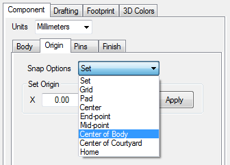

Post Options Post Options   Thanks (0) Thanks(0)   Quote Tom H Quote  Post ReplyReply Direct Link To This Post Posted: 14 Feb 2015 at 9:38am
We added more FP Designer "Origin" tab options.
Center of Body and Center of Courtyard options are now available.
