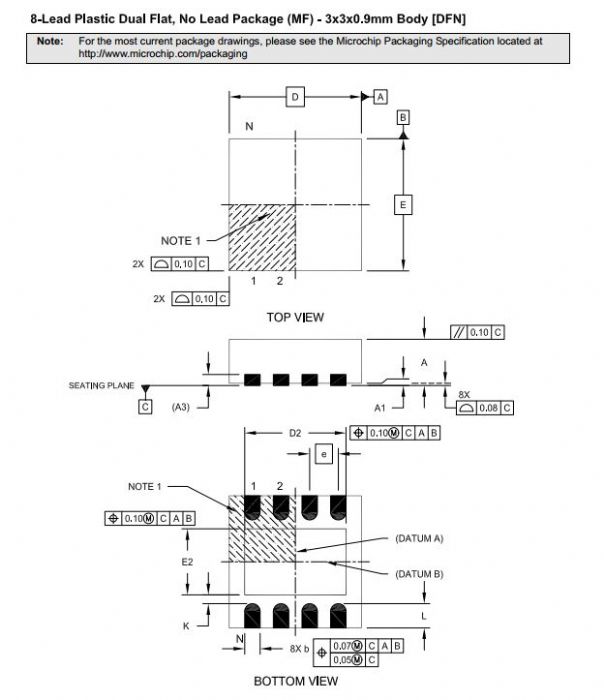

I am trying to work on some packages but unfortunately tool not support as sample DFN 8 pin it support only DFN 6 pin is it possible to update tool with this package?
Points: 6092
Post Options Post Options   Thanks (0) Thanks(0)   Quote Tom H Quote  Post ReplyReply Direct Link To This Post Posted: 31 Jul 2017 at 6:42am
The part is and Small Outline No-Lead (SON with Tab).
It's not a Dual Flat No-Lead (DFN) as they only come in 2, 3 and 4 pin versions.
