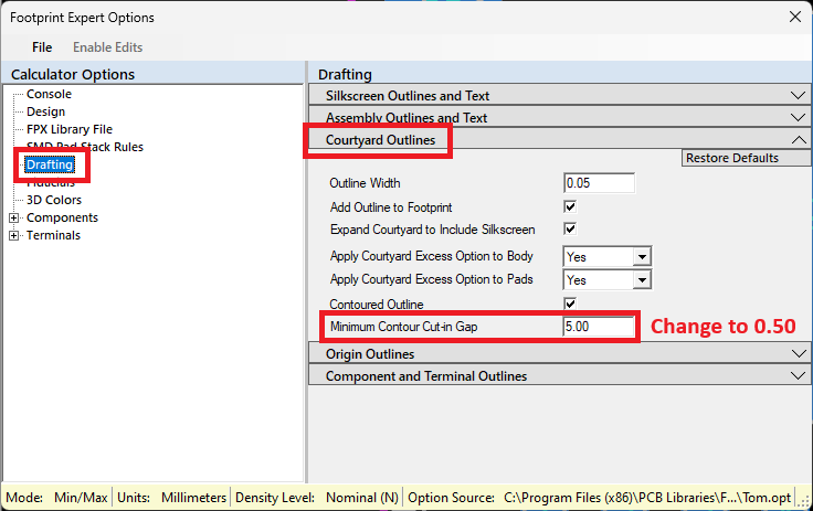

Post Options Post Options   Thanks (0) Thanks(0)   Quote Tom H Quote  Post ReplyReply Direct Link To This Post Posted: 07 Jan 2025 at 12:15pm
There is an Option feature in "Tools > Options > Drafting > Courtyard > Minimum Contour Cut-in Gap".
The default setting is 5 mm but you can change the value to whatever you want and the courtyard will cut in-between pads.
