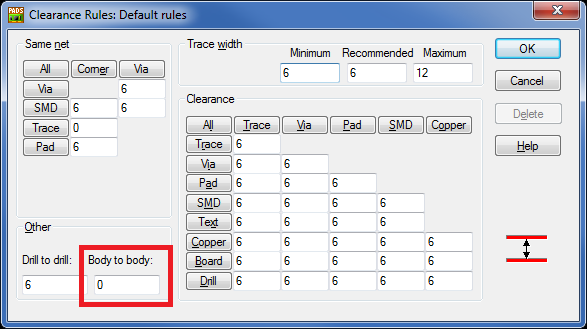

These resistors RESC1608X55N are placed 1.5mm apart - center to center.  Each courtyard short side is 1.5mm.  The Body to Body clearance is 0.  I still get an error
The Courtyards on/off work as suggested - thanks!
Points: 5798
Post Options Post Options   Thanks (0) Thanks(0)   Quote Tom H Quote  Post ReplyReply Direct Link To This Post Posted: 24 Aug 2012 at 8:58am
In the "Verify Design" SETUP there are different options.
Body to Body is one and Placement Outline is another. It seems that you have both turned on.
Turn Placement Outline off and try it.
Turn Body to Body off and try it.
