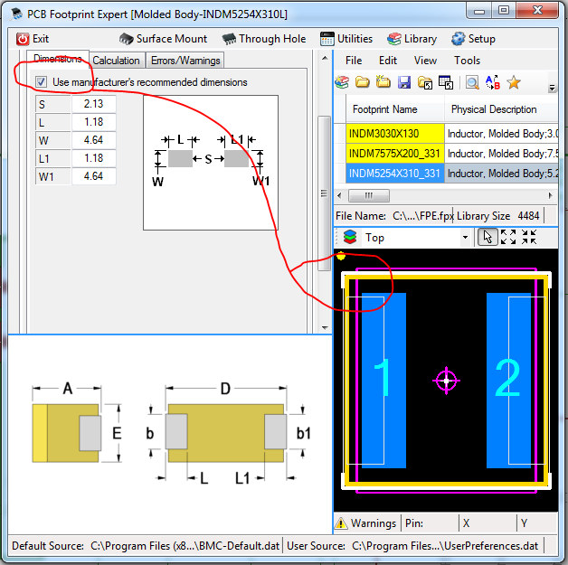

Using 2012.52 on Win7 x64.

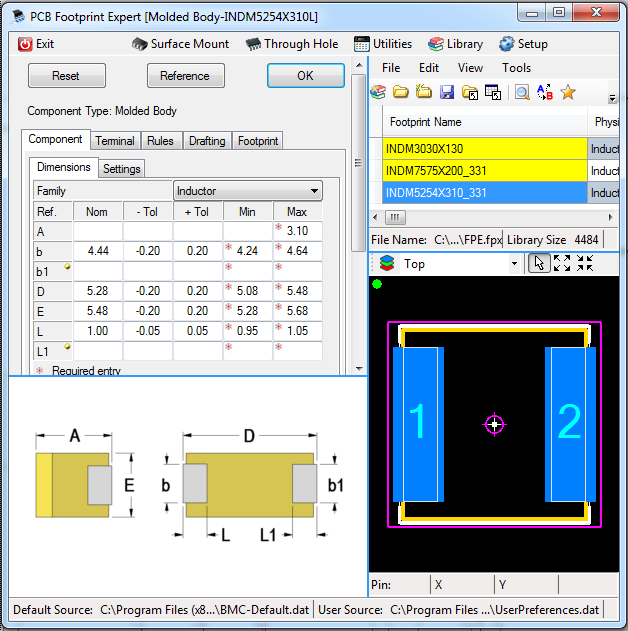

I went to create a new inductor from a CoilCraft datasheet.  I entered the dims and clicked OK.
Then I decided that I needed to use the mfr recommended footprint.  Made the changes per the datasheet, hit OK and noticed that the courtyard moved to reflect the new pad locations but it was now INSIDE the silk/assembly outlines.
I think this new courtyard would certainly cause issues when placing on a tight circuit board.
Billy

No problem - http://www.coilcraft.com/pdf_viewer/showpdf.cfm?f=pdf_store:xal50xx.pdf
I was using the dimensions from the dash number -331 part.
So, starting with a new inductor and entering the dimensions shown on the first image should have produced a good courtyard.  However, when entering the numbers shown on the Footprint\Dimensions tab with the Use Mfr dimensions checked, you should have been able to see the courtyard restrict while the silk / assembly info remain the same.
