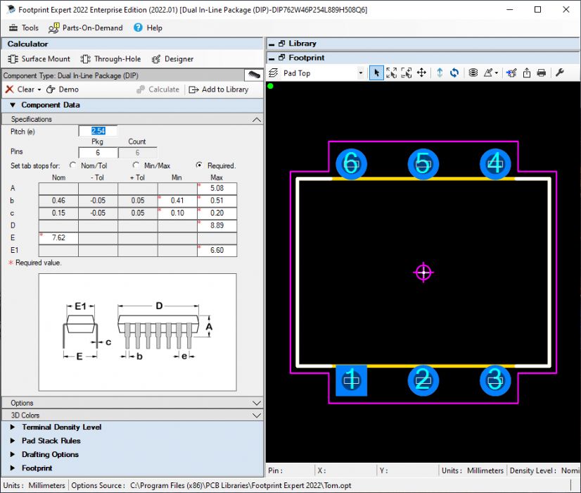

Post Options Post Options   Thanks (0) Thanks(0)   Quote Blaylock Quote  Post ReplyReply Direct Link To This Post Posted: 07 Jan 2022 at 11:10am
Points: 6104
Post Options Post Options   Thanks (0) Thanks(0)   Quote Tom H Quote  Post ReplyReply Direct Link To This Post Posted: 07 Jan 2022 at 11:16am
This is the PDIP6 in V2022.01 Footprint Expert through-hole calculator.
What is the problem?

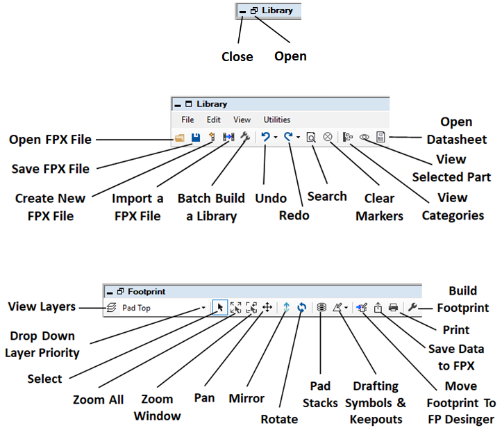

Post Options Post Options   Thanks (0) Thanks(0)   Quote Tom H Quote  Post ReplyReply Direct Link To This Post Posted: 07 Jan 2022 at 1:33pm
There's an icon button in the toolbar that allows you to move most footprints from the Calculator to FP Designer.
