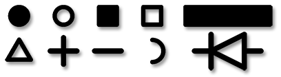

My favorite feature is to manually add all Polarity Marking for Silkscreen and Assembly layers.
This way you can place any shape, size and location as a 2D-Line.
Small parts get small polarity markers and large parts get big polarity markers.
Capacitors get + symbols and diodes get diodes with Anode/Cathode and connectors get triangles, SOP's get dots or squares or triangles. They can be filled or unfilled.
Here is the current list of symbols, but we're adding more.
The auto-move feature in Footprint Expert works on a course grid when zoomed out and a fine grid when zoomed in. Making placement in the perfect location easy.
