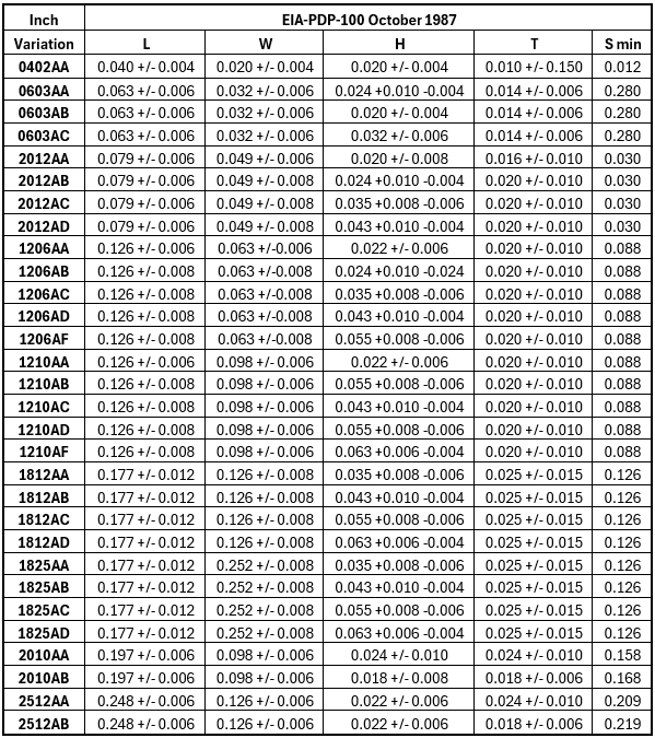

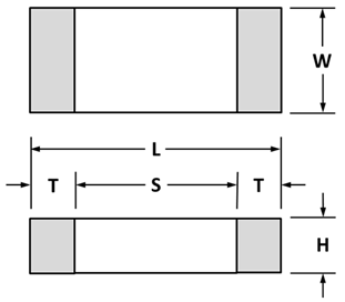

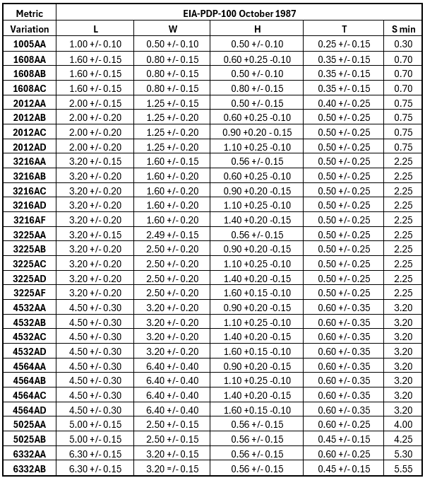

EIA-PDP-100 for Chip Components
(published October 1987)
EIA-PDP-100 Chip package dimensions:
EIA is the 'Electronic Industries Association'. EIA published the first standard dimensional data for chip component packages.
Purchase a PDF copy of the EIA PDP-100-1987: Registered & Standard Mechanical Outlines for Electronic Parts for $7.50 here: https://www.normisland.com/
