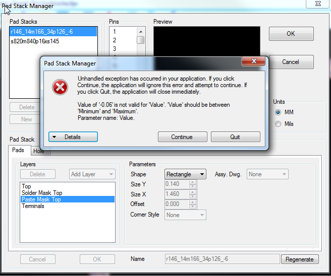

found a little thing here. I Created a 176pin QFP with Datasheet.
the Paste Mask Top created a -Size and the Pad Stack Manager says Error.

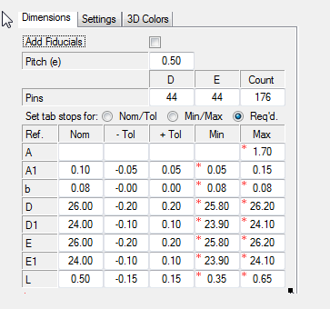

There are couple things that might lead to a negative paste mask value
The b dimension seems pretty small.  Are you sure it's 0.08 mm?
I checked a few comparable datasheets and the terminal width is typically 0.17 - 0.27.
This small dimension with a small side protrusion goal and a shrink on the solder mask could add up to a negative.
Points: 6106
Post Options Post Options   Thanks (0) Thanks(0)   Quote Tom H Quote  Post ReplyReply Direct Link To This Post Posted: 22 Jun 2016 at 8:07am
The only thing I see that's wrong is the "b" lead width has no tolerance and it should, but that would not cause the error but it will cause a bad Land Pattern Footprint. An insufficient pad width.

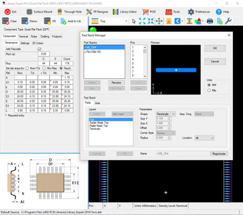

Are you using V2016.07?
Here is what I get when I enter your dimensions -
