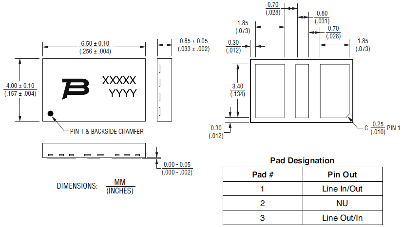

Anybody here having experience with the Bourns TBU-CA High Speed Protectors?
I think the datasheet description of the Pad Layout is a bit unclear.
What Component Category should be used to make the layout?
Thanks

Hi Lars,
The datasheet says its a DFN package:-  However the 3 pins are arranged different than this tool. so I probably would use the 2 pins DFN option and modify it for 3 pins. or just draw it yourself.. not sure if that helps Ouch

This Bourns TBU-CA is a 3-Pin DFN but it's the first one I've ever seen with 3 pins in a row -
We will have to create a new component family template for this part, but in the meantime you can create the library part using the 2-pin DFN and add the middle pin in your CAD tool library editor. I would make the size of the middle pin the same size 0.05 mm annular ring larger than the lead size.
Are there any more of these 3-pin DFN parts out there? We do not like to create component families for unique one-of-a-kind package.
This request for a new component family belongs in the "Product Suggestions" Forum -
