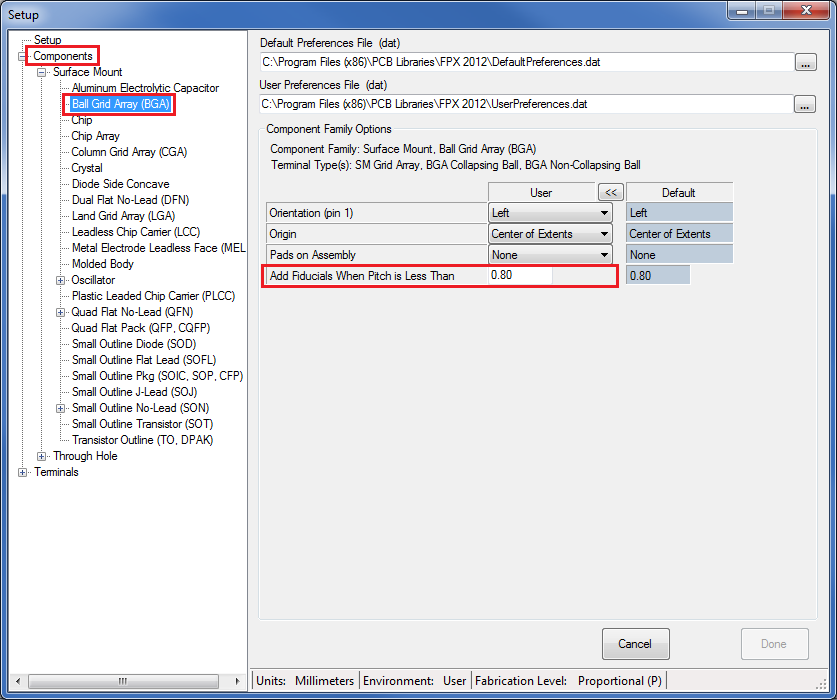

Post Options Post Options   Thanks (0) Thanks(0)   Quote Tom H Quote  Post ReplyReply Direct Link To This Post Posted: 15 Apr 2013 at 6:18pm
In the "Full Version" you can permanently change the Local Fiducials in the "Setup > User Preferences > Component > BGA > Add Fiducials When Pitch is Less Than ?" -
If you have the "Lite Version" you have to enter all your component package values and then select "Add Fiducials" radio button.

Post Options Post Options   Thanks (0) Thanks(0)   Quote LMizz Quote  Post ReplyReply Direct Link To This Post Posted: 16 Apr 2013 at 6:52am
Hi Tom - I do have the "Full Version" so going in to the preferences as you stated took care of the issue for me. I didn't realize the conditional equation was set to "less than" rather than "less than or equal to". Thanks.
