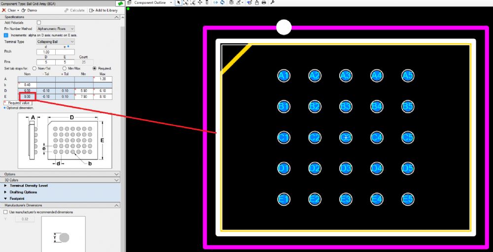

D & E size always get interchange

I did not move anything, A1 defaults to the upper Left - do you even look & check at your own software?

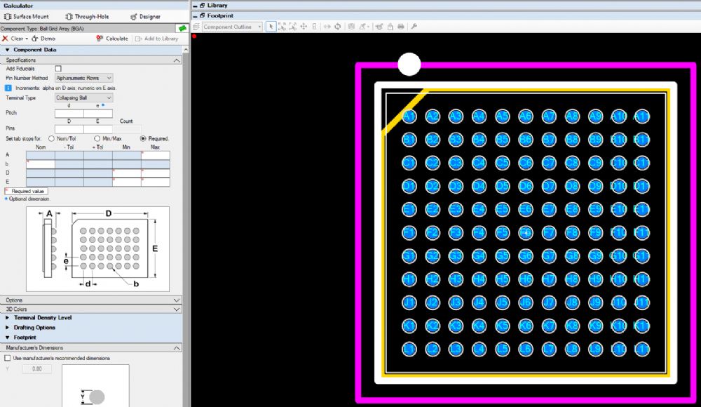

Open Tools > Options and select File > Internal Defaults
Then select File > Save As > whatever Name You Want.
Then open the BGA calculator and see where pin A1 is.
