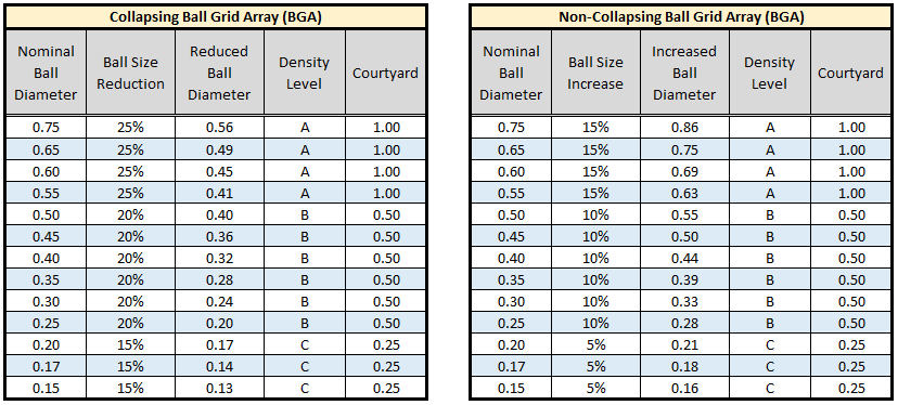

Commonly, what’s maximum diameter difference between BGA ball and ball pad on PCB can be accepted?
Tom H ![]() Admin Group ![]() ![]() Joined: 05 Jan 2012 Location: San Diego, CA Status: Offline Points: 5301 |
Here is a BGA pad size calculation table.
