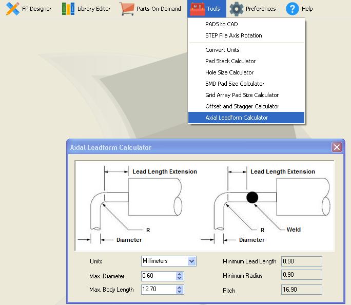

Can anyone please tel me how to calculate pitch for Axial Components like resistor, Diode, etc.
Thanks
mahmoodv99 View Drop Down
Joined: 16 Jan 2016
Points: 93
Post Options Post Options   Thanks (2) Thanks(2)   Quote mahmoodv99 Quote  Post ReplyReply Direct Link To This Post Posted: 26 May 2016 at 2:39am
You can use Axial Lead form calculator from Tools Smile

Choose the "Tools" icon from the Main Toolbar and then select the Axial Lead Form Calculator.

I do not have access to the latest revisions of either of these standards, so maybe it was updated. In the version I have, the calculation for the lead length extension is specified as "straight for 1 diameter/lead thickness, but not less than 0.8 mm [0.031 in]."
Library Expert calculates a value much larger than this for the lead length extension. For example, for a lead diameter of 0.8 mm, Library Expert calculates a lead length extension of 2.40 mm – three times the value suggested by my copy of the standard.

2.4 mm is correct for a 0.8 mm dia lead with a standard bend form (as opposed to a welded bend) component, per IPC.
To calculate the lead bend extension from the end of the part, you need to add the other parts of the calculation which are the value of the minimum bend radius (R), plus the radius of the lead.
Per IPC-2221A:
The Minimum Radius (R) is dependant upon the maximum component lead diameter where:
R = 1 for max lead diameter up to 0.8 mm
R = 1.5 for max lead diameter 0.8 mm to 1.2 mm
R = 2 for max lead diameter larger than 1.2 mm

For the total pitch, yes. But (at least according to the revision I'm looking at, as well as the diagram in Library Expert's Axial Leadform Calculator) the lead length extension (L) is from the end of the part (or weld bead) to the beginning of the bend. This value does not include the bend radius or lead radius. Those are added to L to determine the pitch.
So, in math, my reading of the IPC calculation is:
b : lead diameter
D : part length, including weld beads if any
L : lead length extension
R : bend radius
m : bend radius multiplier, according to the table in Ian's message
e : pitch
L = max( 0.8, b )
R = m b
e = D + 2 ( L + R + b / 2 )
