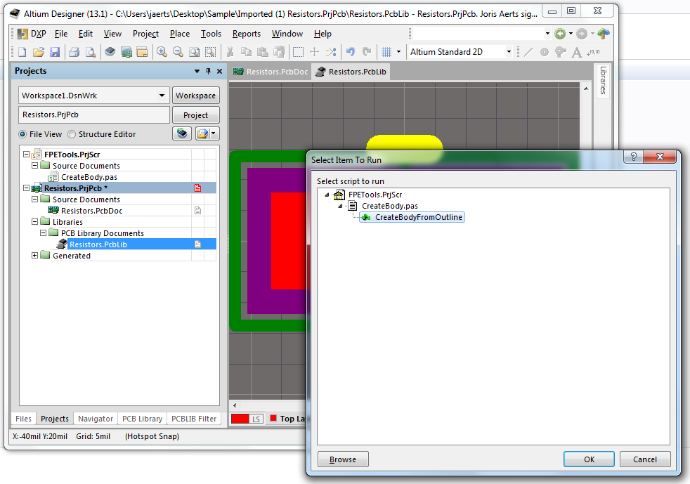

Hi All,
I've created an Altium script that automatically generates 3D bodies based on the 3D outline as exported by FPE, and the height in the IPC filename.
Although they are a little simpler I strongly prefer this over step files, since they are much lighter to handle (especially for big boards).
I'm releasing it here under Attribution-ShareAlike 3.0 United States:
http://creativecommons.org/licenses/by-sa/3.0/us/
Everything is provided as-is and is not affiliated with PCB Libraries in any way.
Download:
Instructions:
- Build and Import your library as you would normally do.
- Make sure the attached FPETools is opened in Altium
- Open up the newly created Lbrary
- Click DXP -> Run Script -> CreateBodyFromOutline
- Save the library
Best regards,
Joris
