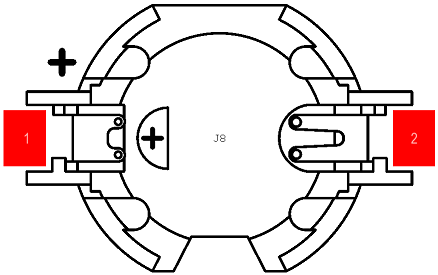

You're correct. I was referring to parts like this SMT speaker. This silkscreen outline does not help the PCB designer, fabrication or assembly process. And it's covered up after assembly except the "+".

I see your point Tom, and in the case of silkscreen I totally agree, but I haven't mentioned silkscreen in my question.
I was referring to how to slightly improve the Assembly drawing, that is (still) used not only by prototype assembly people but also the guys that have to repair in the fields.
A simple line/box/triangle/circle/text would certainly help to clarify in many cases, without adding too much complexity/info to the footprint data.
That SMT speaker example is way too complex and is absolutely NOT what I would prefer.
/Benn

First, these comments are for production boards.  If you are just doing low run boards, add all the detail you want/have time for, as your assembly process may have NO automation, and then you just might need all that stuff.
The only time I add extra to the assembly, is if it helps place/ID the part.  If I get the DXF Tom has above, I'd remove about 95% of the details.  I'd leave the outer edge, and the internal "+", maybe the internal circle and the some of the pin details, depending on if it helps get the part placed correctly.
