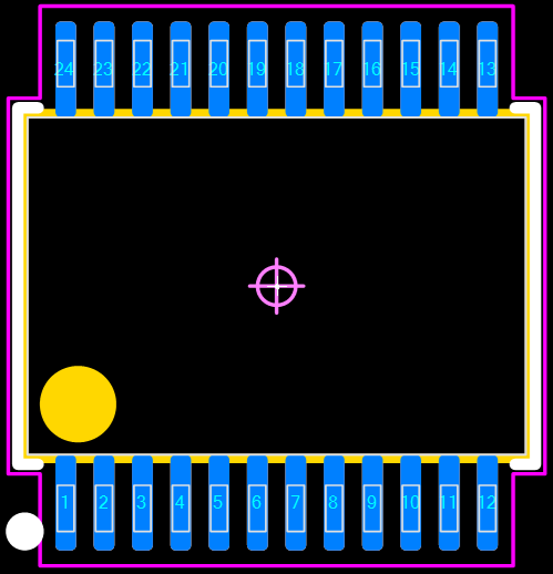

In V25.10 we added a new feature to replace the Assembly Polarity Chamfer with a Dot.
Now you want us to add a new feature to allow the user to place the new Assembly Dot in the same location as the Silkscreen Polarity Dot.
V25.10 is the last release this year and we're currently preparing it for the official release next week in October.
We might be able to do that in V26 next year.

The polarity marker on the Silkscreen layer (as it's used for post-assembly inspection) is outside the footprints's outline.
For the Assembly layer, I prefer to place the marker inside the outline.
If Footprint Expert will have an option to place it in the same location as the dot on the Silkscreen layer, I'll probably never use it.

Here is the new Assembly Polarity Dot in a SOP footprint.
You can select the Minimum / Maximum dot diameter in Assembly > Options.
You can toggle between Assembly Chamfer and Dot, whichever you like best.
Options are not saved to FPX. Options are automatically applied when you open a footprint.
