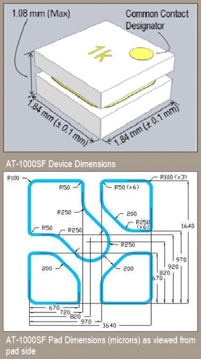

As of the last year in my company at least there has been a migration from large leaded switches (G & Accel in my case) to 2 & 4 pin DFN packages. So is it possible to get a switch added to the DFN family pull-down list?
For reference if needed you can look at almost anything from HT Micro (http://www.htmicro.com/).

These types of DFN packages must use the mfr. recommended pattern.
There is no IPC Calculator for this custom package.
However, this is really cool technology and we would like to add this pattern to POD.
