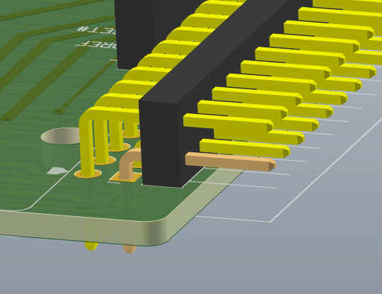

In Footprint Expert, I love the possibility to use a dedicated 3D color for pin 1, in particular for headers. But I think this feature could be improved a little...
Here is what a "HDR" part looks like with my config:

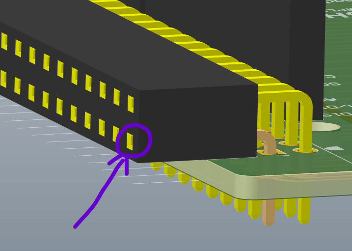

And now a "RHDR" part:
Could we think about an improved version in which the inner pin 1 of a receptacle also takes the specific "Pin 1 color"? This would be very handy to ensure the correct matching of pins in case of mating connectors.
Thanks!
Justin
Post Options Post Options   Thanks (0) Thanks(0)   Quote Tom H Quote  Post ReplyReply Direct Link To This Post Posted: 27 Feb 2024 at 6:17pm
The way the master 3D STEP models were created make it impossible to make both the Terminal and the Receptacle hole a different color.
The Receptacle hole was created as an extruded cut.
The Terminal Leads were created differently. The lead starts on the face of the body.
But we'll take a look at it.
