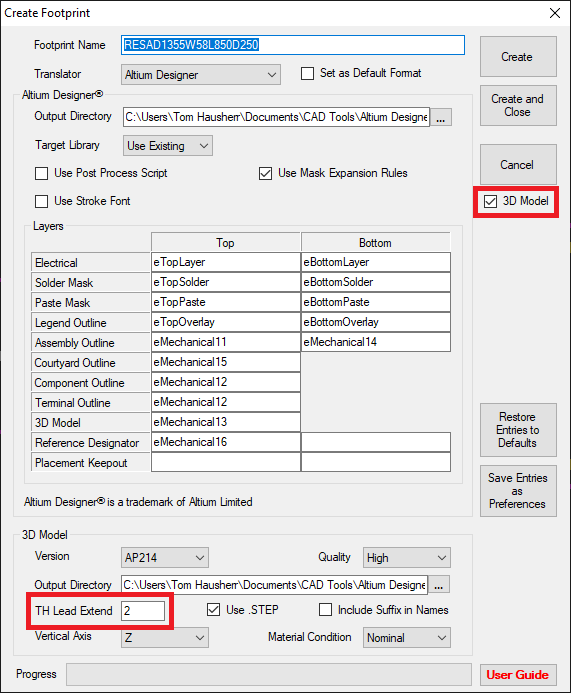

Controlling the through-hole lead length has always been possible.
All through-hole leads stop at the top of the PCB.
The User enters a value on how far the lead goes through the board and out the back.
You need to have 3D models that can handle any PCB thickness.
