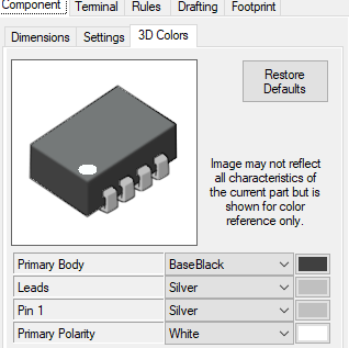

When I export my part to Altium there is no white dot on the 3D model as show here.
Thoughts?

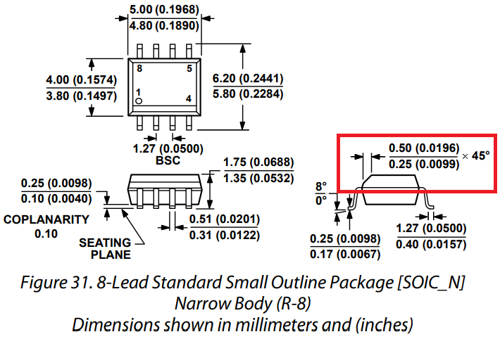

It is an SOIC-8. The Analog Devices R-8 package.
Here is a link to a part that uses that package.
Points: 6075
Post Options Post Options   Thanks (1) Thanks(1)   Quote Tom H Quote  Post ReplyReply Direct Link To This Post Posted: 13 Jan 2021 at 4:11pm
This package is not a metric pitch SOP.
It is a 50 mil pitch SOIC.
The Polarity Marker is a Chamfered Body along the entire upper edge of Pin 1.
