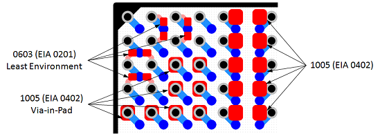

Turn on Rounded Rectangle pad shape for the 0402.
Here is a 1 mm pitch BGA with dogbone fanout.
The 0402 can be perfect center via-in-pad or located in-between fanout vias if there's room.

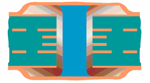

I would go for the via-in-pad with plugged via. You can see where the Rounded Rectangle pad shape passes DRC clearance checks. Cap the via-in-pad with surface finish, planerize flat and ready for reflow with BGA fanout on one side and capacitor pad on the other side.

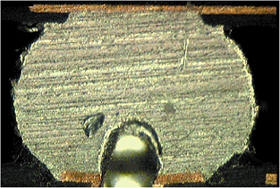

With capacitors, a small "dimple" (with trapped air) in the pad would not create a void cavity in the lead like they do in BGA via-in-pad. 25% void is acceptable.
