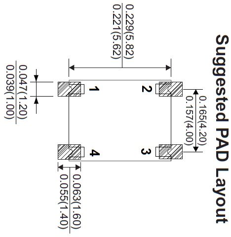

I am building my footprints according to Zero orientation level B. Now I came across the following part with the highly unusual clockwise pin numbering starting from the top right corner. See attachment.
uploads/527/Comchip_Z4GP206-HF_bridge_rectifier.pdf
What would you suggest me to do to create the correct orientation and pin numbering in the footprint? Of course with a high emphasis of presenting this in a logical way to a assembly shop, to prevent them messing up the orientation.
I'm tempted to redefine the pin numbering myself according to the usual counterclockwise numbering starting bottom left. With a notification about this in the schematic. Then the zero orientation is also with the readable text on the package. What do you think about this?

Post Options Post Options   Thanks (0) Thanks(0)   Quote Tom H Quote  Post ReplyReply Direct Link To This Post Posted: 21 Dec 2014 at 5:57pm
The Comchip Bridge Rectifier datasheet is 180 degrees out of IPC-7351C Level B Zero Component Orientation.

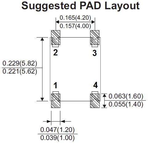

Post Options Post Options   Thanks (0) Thanks(0)   Quote Tom H Quote  Post ReplyReply Direct Link To This Post Posted: 22 Dec 2014 at 9:33am
IPC-7351 Level B and IEC 61188-7 are identical zero component orientation.
Here is the Bridge Rectifier Level B Zero Component Orientation, Pin 1 is Lower Left.
Here is the Bridge Rectifier Level A Zero Component Orientation, Pin 2 is Upper Left.
