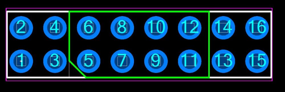

Hi!
"Assembly drawing top" and "component outline" does not work for other sizes than 4x2.
I am using LEEE 2018.02
Cheers
/Benn

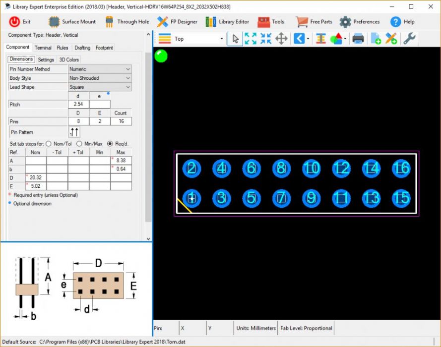

Post Options Post Options   Thanks (0) Thanks(0)   Quote Tom H Quote  Post ReplyReply Direct Link To This Post Posted: 21 Mar 2018 at 5:45am
Is your "D" dimension 20.32?
We need to see your other settings. Are you available to do a webcast so we can see what you are doing?

Post Options Post Options   Thanks (0) Thanks(0)   Quote BennsPCB Quote  Post ReplyReply Direct Link To This Post Posted: 21 Mar 2018 at 7:33am
Hi Tom. Problem solved!
You are right. It was a typo in D-dimension that was the problem.
Still, I'd like to get a warning if such an obvious error occurs.
Cheers,
/Benn
Points: 6091
Post Options Post Options   Thanks (0) Thanks(0)   Quote Tom H Quote  Post ReplyReply Direct Link To This Post Posted: 21 Mar 2018 at 7:35am
You do get a warning...
The footprint looks screwed up. That's your warning. Smile
