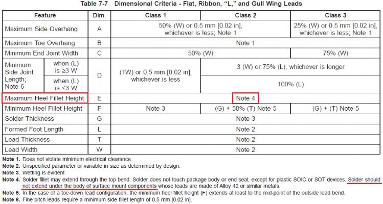

The entire pad trimming under low profile Gull Wing components started when I took a J-STD-001 training class and the teacher pointed out this table 7-7 and Note 4 regarding the Heel Fillet -
So we created the "K" dimension for the IPC-7351 standard to sync with J-STD-001.
The problem was that we didn't read the entire line that states not to extend pads for "Component Leads Made of Alloy 42".
So we added a new feature to the LP Calculator thinking that we were saving the world from under body solder joint short circuits, but the fact is no one ever reported an assembly problem with pads under component body. As a matter of fact, by trimming the pads under component bodies we actually removed solder from the heel (which 70% of the solder joint strength is derived).

The standard needs to be challenged to refine it into perfection. From what I remember in our last standards meeting was that IPC was going to inquire to update the J-STD-001 and revise the "Note 4" verbiage for Gull Wing Heel solder joints to avoid confusion. The various IPC standards need to match and cannot contradict each other.
Many of your comments and concerns were discussed in our last land pattern standards meeting, but the one fact that kept surfacing was "who complained about the pads under the component?" and the answer was "no one". i.e.: no one challenged the standard on this issue. The pad trim feature was added to the calculator even though we never received an under body solder bridge complaint. Dieter Bergman contends "Don't fix something if it's not broken".

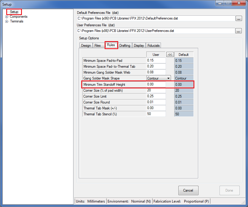

The "Trim Pad" feature is in the PCB Footprint Program.
Open the "User Preferences > Rules > Minimum Trim Standoff Height" and change the value to whatever component standoff value you want to start trimming pads. i.e.: If you enter 0.15 mm, any component standoff less than 0.15 mm will invoke pad trimming under the component body.
IPC just told us to turn the value off, they did not tell us to remove the feature.

I am aware that the feature is still there, but off by default.  I was more interested to know if there if anybody has ever commented about solder joint reliability due to trimmed lands.  Thanks for the reply.
