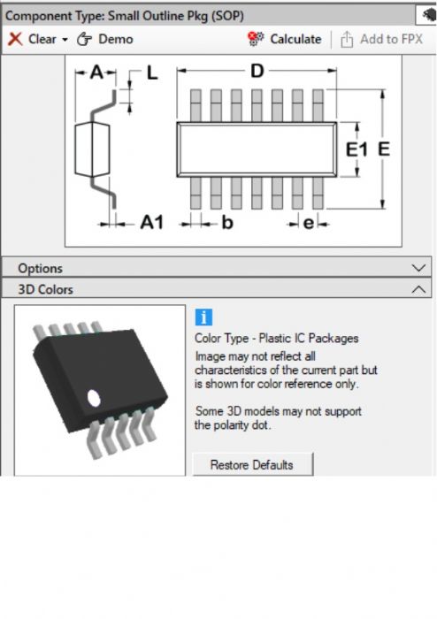

1-i need more detail by what means "some 3D missed dot polarity"?
2-what are the packages have this note?
3- how to correct this dot on 3D?

This package is not a Metric Pin Pitch SOP. The Package Marking has a Dot and no chamfer on the body.
It is a 50 mil (1.27 mm) pin pitch SOIC. These packages were introduced in the early 1980's when the package had a 45 degree chamfer all along the Pin 1 edge. No Polarity Dot.
You need to know the difference between Imperial and Metric pin pitch packages.
We have no plans on changing this polarity marking concept that been around for the past 35 years.

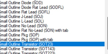

Post Options Post Options   Thanks (0) Thanks(0)   Quote m.elsayed Quote  Post ReplyReply Direct Link To This Post Posted: 23 Sep 2025 at 5:50pm
Can please have details for each package type in image like SOD, SODFL,SOFL,....SOJ, SOL,.... SOT223 (All package on mage)
What pitch should have dot and what pitch shouldn't have dot like what you explained for SOP package.

Post Options Post Options   Thanks (0) Thanks(0)   Quote Tom H Quote  Post ReplyReply Direct Link To This Post Posted: 23 Sep 2025 at 5:59pm
All SOT23s are metric pin pitch.
  • 0.95 mm
  • 0.65 mm
  • 0.50 mm
SOT223s come in various metric pin pitches and different pin quantities.
All SODs are 2-pin packages. No pin pitch.
All SOJs and SOLs are Imperial pin pitch and are on there way to becoming Obsolete.
All QFPs are metric pin pitch.
SOICs are Imperial unit pin pitch and they are the only component family with a Chamfer on the Body along the top edge of where pin 1 is.
