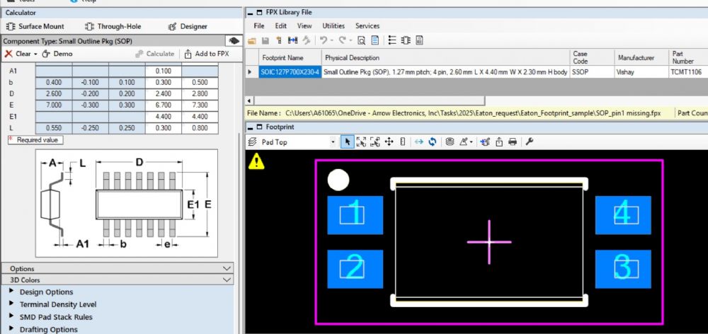

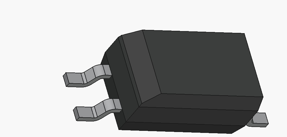

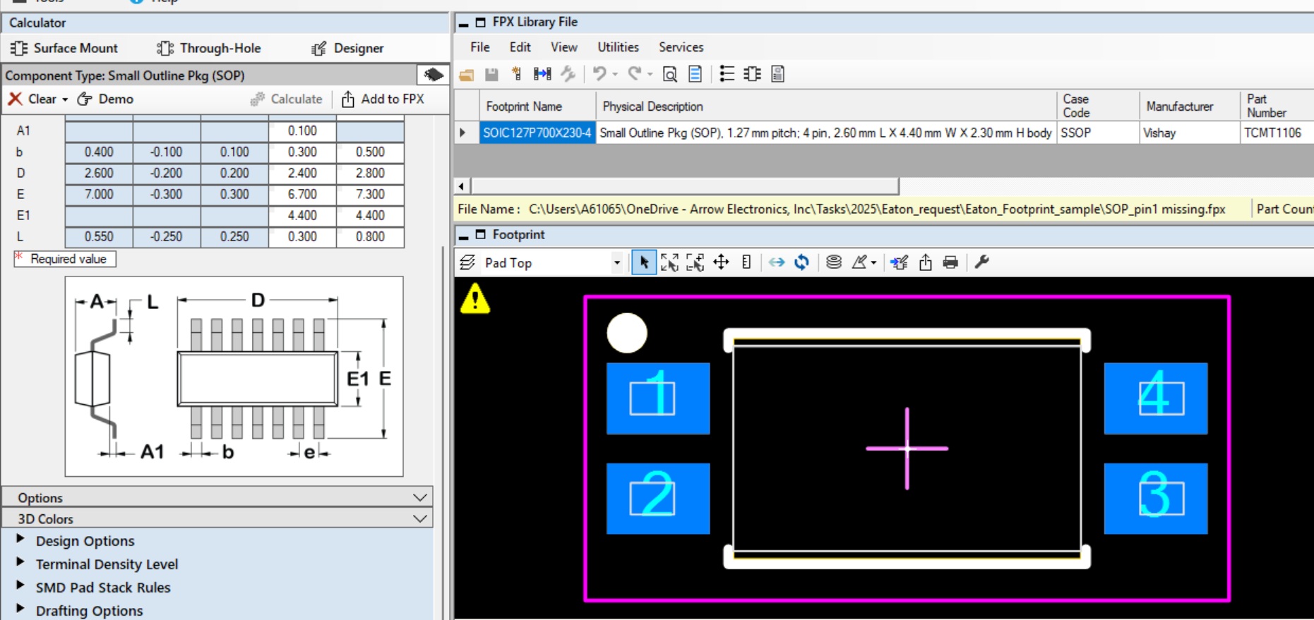

there is missing for pin 1 marking in generated 3D , can please check in SOP package as example, and check for others packages also
generated from tool
corrected ONE
fpx example

Hi
please check fpx file and it let us why there no dot on 3D like only normal 3D for this package

Post Options Post Options   Thanks (0) Thanks(0)   Quote Tom H Quote  Post ReplyReply Direct Link To This Post Posted: 23 Sep 2025 at 1:36pm
This package is not a Metric Pin Pitch SOP. The Package Marking has a Dot and no chamfer on the body.
It is a 50 mil (1.27 mm) pin pitch SOIC. These packages were introduced in the early 1980's when the package had a 45 degree chamfer all along the Pin 1 edge. No Polarity Dot.
You need to know the difference between Imperial and Metric pin pitch packages.
We have no plans on changing this polarity marking concept that been around for the past 35 years.
