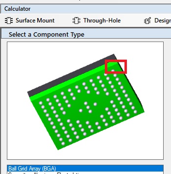

For BGA packages result shape of PCB along with 3D as shown in image below.
The Green Color representing the FR4 substrate material needs to be removed from some BGAs.
Below sample FPX.

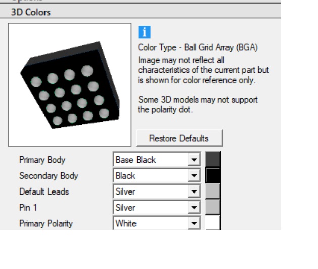

Post Options Post Options   Thanks (0) Thanks(0)   Quote Tom H Quote  Post ReplyReply Direct Link To This Post Posted: 23 Sep 2025 at 8:32am
You can change color assignments in the Calculator 3D Model Color panel.
Change the Green Substrate to Black.
You have complete control of every color assignment for every component family.

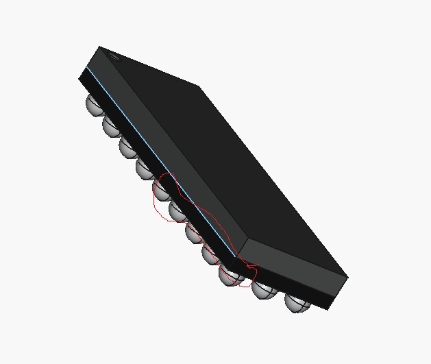

Hi
i try do this like below image
but note result 3D black not same as substrate one
 is there way to make primary body and secondary one be same colour level

Post Options Post Options   Thanks (0) Thanks(0)   Quote Tom H Quote  Post ReplyReply Direct Link To This Post Posted: 23 Sep 2025 at 2:00pm
Do Not Select 'Black'
Select the same color as the Primary Body 'Base Black'.
Black and Base Black are 2 different colors.

Post Options Post Options   Thanks (0) Thanks(0)   Quote m.elsayed Quote  Post ReplyReply Direct Link To This Post Posted: 23 Sep 2025 at 3:37pm
That's great, but when open colors window can't find base black, how to reach it please
Points: 6093
Post Options Post Options   Thanks (0) Thanks(0)   Quote Tom H Quote  Post ReplyReply Direct Link To This Post Posted: 23 Sep 2025 at 3:48pm
It's the 3rd color from the top of the scroll list.
Points: 269
Post Options Post Options   Thanks (0) Thanks(0)   Quote m.elsayed Quote  Post ReplyReply Direct Link To This Post Posted: 23 Sep 2025 at 3:57pm
I got it, Thanks Tom
